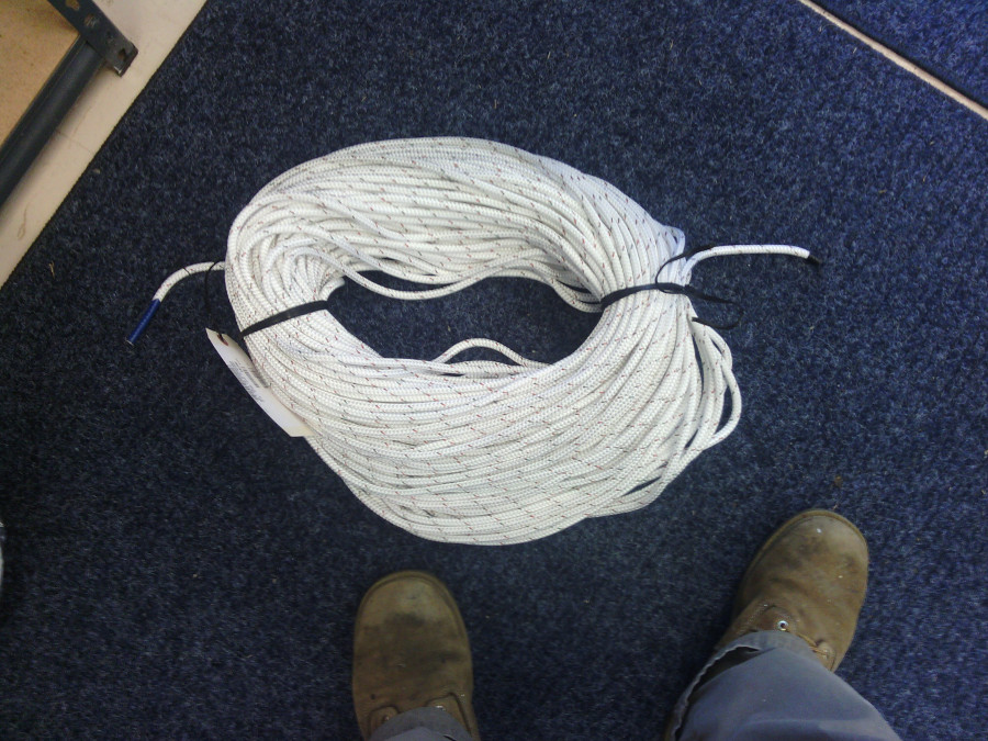

OK...I ordered 300 ft. of 5/16th inch samson yacht braid. Now I need to make up the new halyards. Any suggestions on how to pay it out so I don't put twists in the new halyards?

Maybe I found the answer. Samson says that if the line comes delivered in a coil, it should be uncoiled from the inside so that the first turns come off the bottom in a counterclockwise direction. Reckon this is what I'll do....

This is likely too late, but it appears that this rope was wound onto one of those rope merry-go-rounds that make things so easy -- for the person doing the winding. But you have to get your own merry-go-round or similar to avoid twists when you unwind. Pulling from the center of the coil is an ancient and honorable and effective way to minimize twists when you are using 3-strand rope, but it is useless in this construction.
If you are reading this after the fact, your job now is to sight progressively down the rope, untwisting and cursing the merry-go-round as you go. This is why, whenever I buy rope at a chandlery, I tell them just to run it off and dump it on the floor, so I can coil it over-and-under.

Hi Brion...not too late. I haven't used it yet. The info I got was from the Samson site. Anyway, you're saying I should load it on a reel and uncoil it... I can do that...will make something Sunday.
