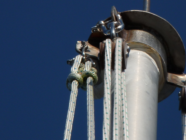

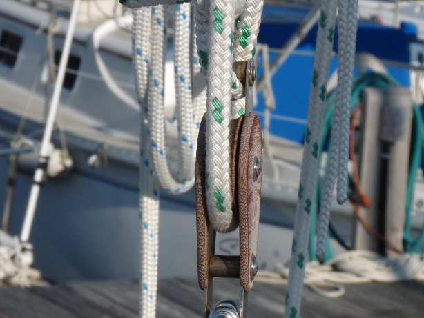

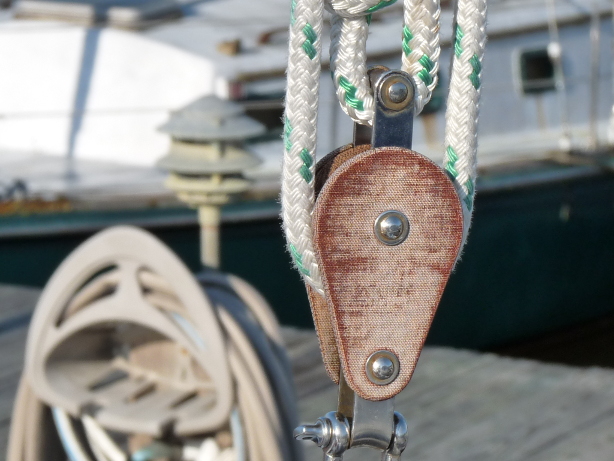

Default Photos of the fore halyard twist
Here are a few pictures of the fore halyard twist....

It doesn't look like Samson's, New England's, or any other major. Unbalanced-at-the-factory is the way to bet.
Fair leads
